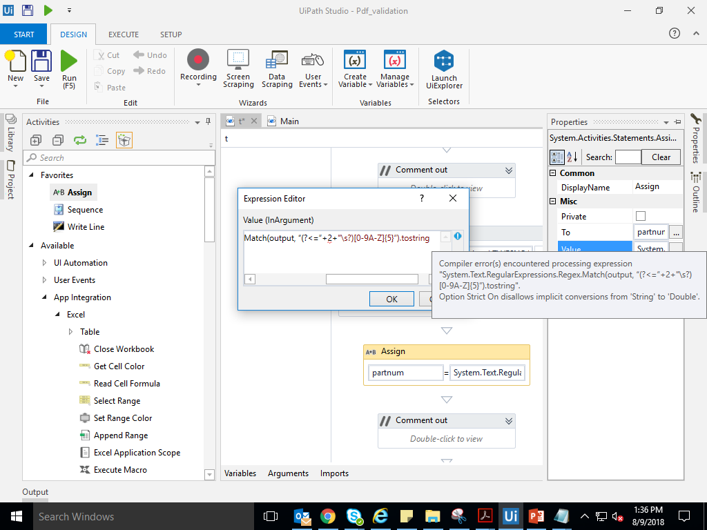

@evangemert could u please help me with regex of text or characters(eg: 2 DS23D, 3 FG23D, 1DRE3W and etc ). So as per the given example I need a text next to 2 after space and 3 after Space and like viz 1, 5 etc all these are any where in text file.
Note: numbers 1,2,3,4,5 and etc are like Index numbers but after extracting pdf data to txt file itwill be not in a defined format hence need regex to get the text after index numbers. I need a logic like if i want only text from specific index number that could be 1 or 2 or 3 or 4 or any. I can change as per my requirement later. So i need logic for one index now then accordingly i can modify it for other index numbers please help
My first idea is making a dynamic pattern by using the index as a variable. Making a solid Regex pattern is gonna be hard though if you only have one number and a space to work with. Is the info you need to extract always 5 characters with only caps and digits? In that case, try this:
pattern = “(?<=”+index+“\s?)[0-9A-Z]{5}”
Then use the pattern as a variable in another assign activity, just like I mentioned above.
The first part of the pattern indicates a lookbehind. In there you can drop the index you’re looking for.
Also I’m not sure if it allows adding strings together inside the argument. A safe way to make sure it works is by assigning the pattern in a different assign activity, and then use the variable pattern inside the actual method, like this:
@evangemert It sems not giving required result or can you tyr this on
“replace part K8Y8C .Run DD Test system is working fine.”
in the above text is standard and I need that K8Y8C is dyanamic this could be any five charcters lenght in caps only to be retrieve. can you please help me in this.
Well yeah, that’s kind of obvious as the current pattern is only looking for characters behind the index. If that info is always behind the ‘replace part’ then you just have to edit the pattern for that:
@evangemert there are two things here to be mandatory one is replace part and second must be working fine i need a text between replace part and .Run DD test system is working fine. Some times the text wud be “Run DD Test system is not fine or not working fine”.
