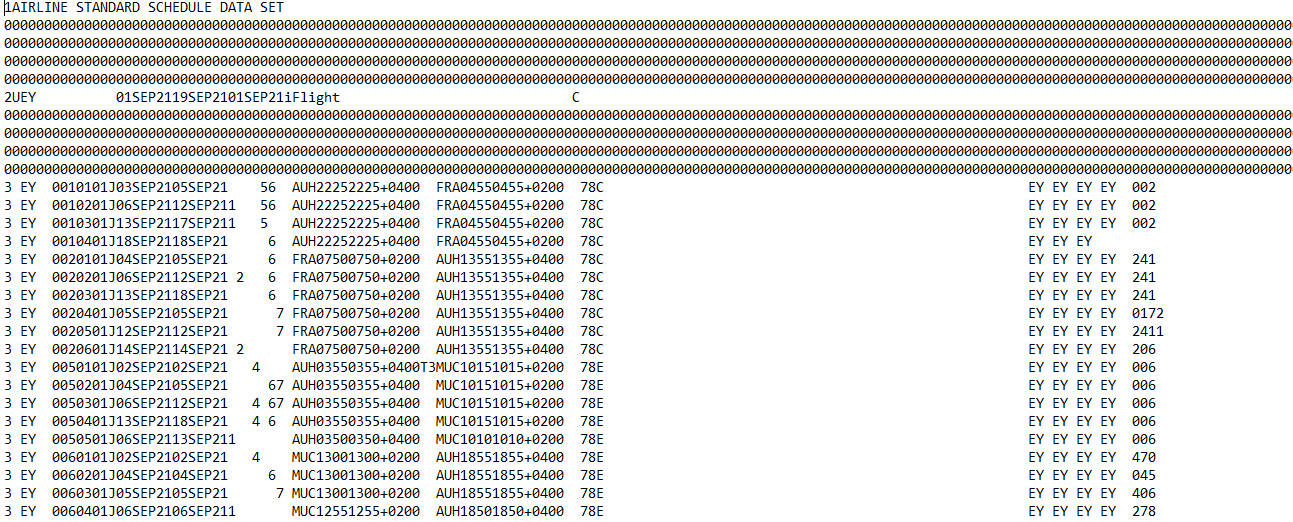

Hi bro @bcorrea, I have seen many of your answers which are really good and helpful. Could you please help me. I have to write the unstructured data from a txt file to excel file. here Im sharing the image of the unstructured data in txt file.
and there are few conditions which has to be followed
  1. Ignore any line numbers that starts with ZERO ‘0’
  2. Read line which starts with ‘2’. If the next character is not ‘U’, Reject the message
  3. Read each line which starts with ‘3’ which will have flight numbers.
  4. Stop when line number starts with ‘5’

Hi @Palaniyappan , Thank you for replying to my question. I’m attaching an image. In which you can find how each line is specified. And I need to add headers as shown in the image.
