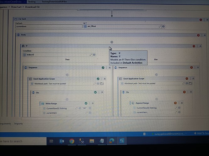

How I’m iterating the data shown in below image
How data is appending and write range by using code

It looks like you’re looping through the data and writing to Excel over and over. You should get the data how you want it first, in the datatable, then just use one Write Range to write it all to Excel.

Please refer above image of my workflow with code

Instead of .Select(function(g) g.CopyToDataTable).ToArray
Use .SelectMany(function(g) g).CopyToDatatable
And write the datatable once and for all to excel…no need of loop

Dt.AsEnumerable.GroupBy(Function(r) r(0).ToString).where(Function(grp) Not grp.Any(Function(a) a(“Match Type”).ToString.trim.Equals(“Confirmed”))).SelectMany(Function(g) g).CopyToDataTable

When I’m using selectmany this exception shows :sweat_smile:
@Anil_G
@suraj_gaikwad
In your assign the variable type of the left argument is array …please change it to datatable …that should solve the issue
Now no need to loop…directly use wrote range
