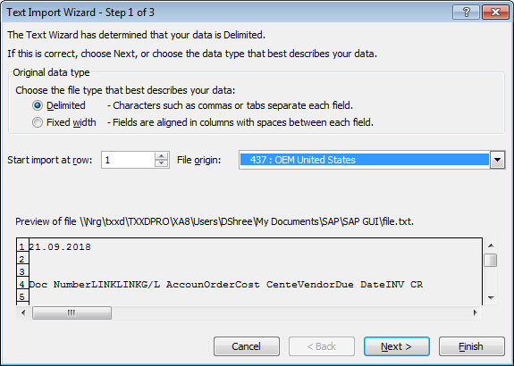

instead of reading from text file and write it into excel you can automate excel,
Go to Data Tab-> from text -> provide input source file->
Select Delimited and other options to structure your data and click on finish.
