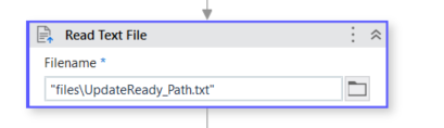

mark your output file like:
WorkshopItems=#WSItems#
Mods=#MDItems#
Read in the file as you had done:
We don’t need the for each
Assign Activity:
strFlattenWSI | String Variable = String.Join(";", RegExModID.Select(Function (m) m.Value.Trim))
Assign Activity:
strFlattenMOD | String Variable = String.Join(";", RegExModName.Select(Function (m) m.Value.Trim))
Assign Acticity:
ServerModsUpdated = ServerModsUpdated.Replace("#WSItems#", strFlattenWSI )
Assign Acticity:
ServerModsUpdated = ServerModsUpdated.Replace("#MDItems#", strFlattenMOD )
And write out ServerModsUpdated / use modified text
