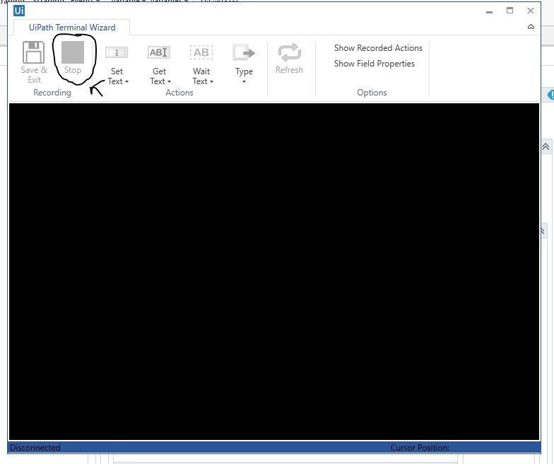

I am working on automating some processes in an AS400 system. I was able to establish a connection and record actions within a few screens before saving and exiting the wizard.
My question is: How do I bring the Terminal Wizard back up if I want to add automation steps from where I left off?
Thanks!
So in order to bring the Terminal Wizard and perform the next steps, you will again need to use terminal session activity perform the previous steps( do not record those steps) and before perform the new steps click on the record button and start performing the new steps. It will record the new steps and then you can save it and append it with the previous step.
