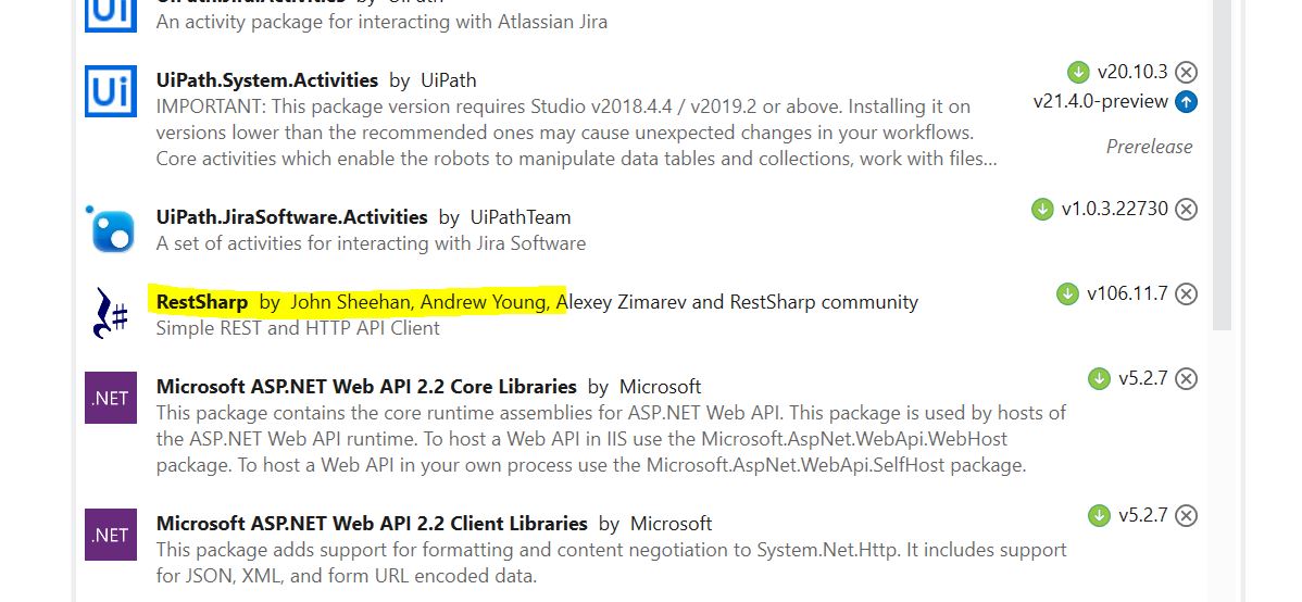

i have downloaded package as suggested and using invoke code .

Add ‘RestSharp’ to imports:
