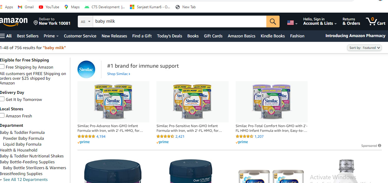

thanks. going ahead stuck in a problem…after changing the pin code we need to search baby milk and after that we need to
- Product Id / ASIN
- Product Name
- Price
- Sponsored – YES/No
- Review Count
- Average Ratings
What is your exact issue ?? if you are stuck in click then in the properties of click activity you need to click on option>simulateType [true]
Here is the sample demo for you. Hope this helps.
PFA - AmazonPinCode_v2.zip (5.5 KB)
Check ads file in the project.
Thanks
