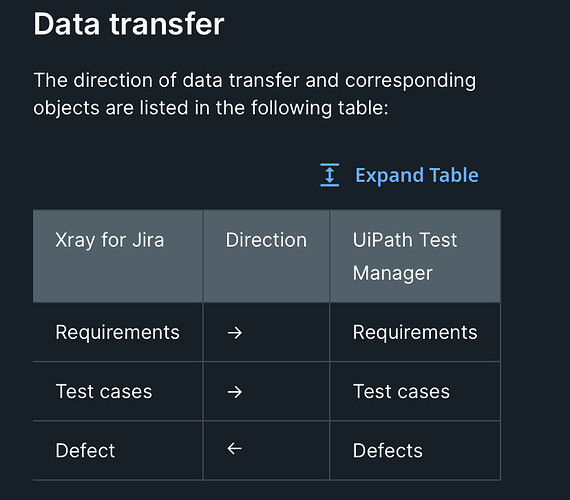

You should able to see the the Requirement & Test Cases. Just try to reconnect once.
Here you will find the directions relationship between Test manager and Jira.
Hi UiPath expert,
Yesterday afternoon, I had an online discussion with your UiPath support team (sorry, I forgot if you were present at the time). Based on the conclusion of the discussion, I have a general understanding of the specific reason. As my problem requires bidirectional synchronization of data between testmanager and jira, according to the conclusion of the meeting, I need to apply for a tasktop hub license to implement it. After I apply for the license on my end, I will contact you for help and guidance, Thank you very much
