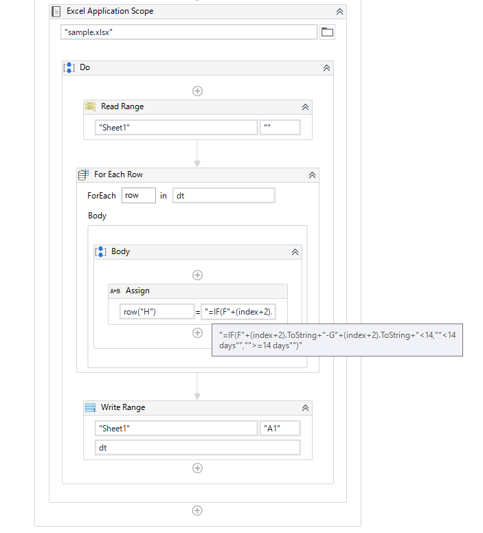

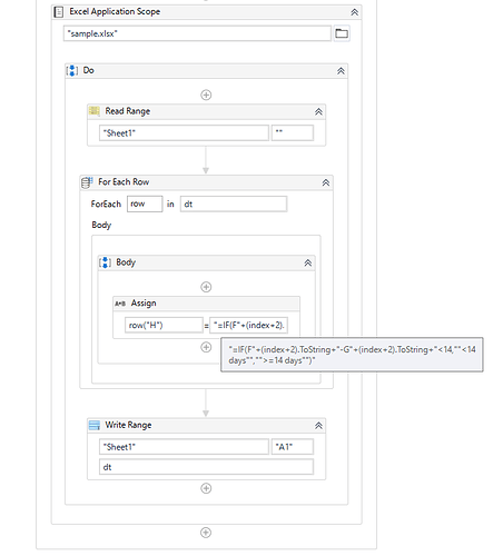

If we can use excel formula, the following might help you.
"=IF(F"+(index+2).ToString+"-G"+(index+2).ToString+"<14,""<14 days"","">=14 days"")"
Sample20211012-2.zip (8.9 KB)

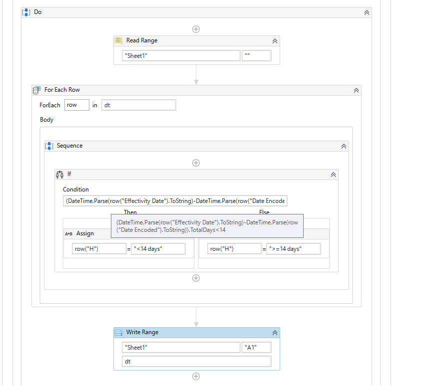

hi @Yoichi
is there any other way to separate the condition like using “IF” activity?
because i have more condition statement after determining if the date encoded is < 14 days of Effectivity date or date Encode is >= 14 Days Effectivity Date
Something like this
Hope the following helps you.
(DateTime.Parse(row("Effectivity Date").ToString)-DateTime.Parse(row("Date Encoded").ToString)).TotalDays<14
Sample20211012-2v2.zip (9.0 KB)
