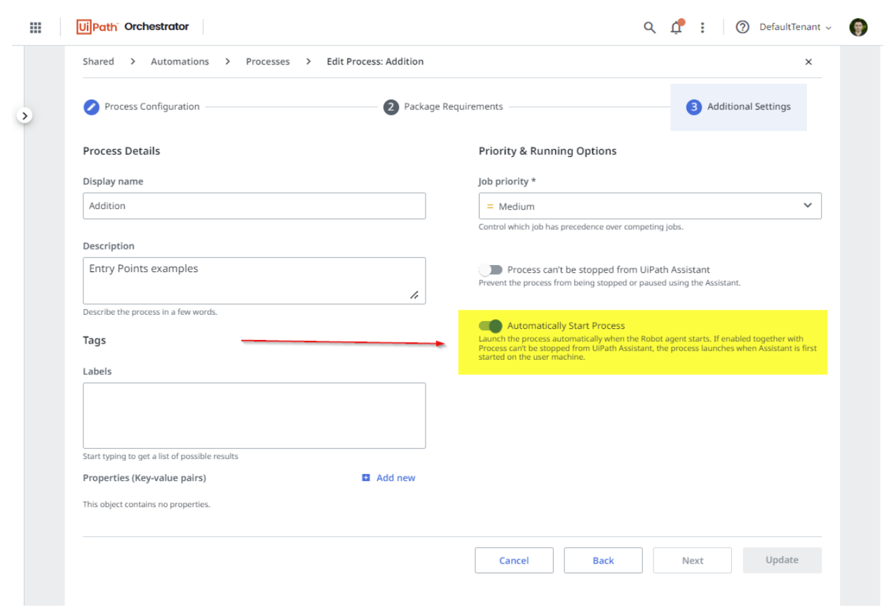

I guess you selected Automatically start process option while creating Process. If yes then uncheck it.

  3. In addition to executing processes from the Processes and Jobs pages, you can also configure any process to automatically start when the Robot agent is launched (when in Assistant your robot is connected to Orchestrator). As an administrator, this enables you to ensure that necessary processes are launched without delay or failure from the machine user, for example, to ensure adherence to company IT policies.

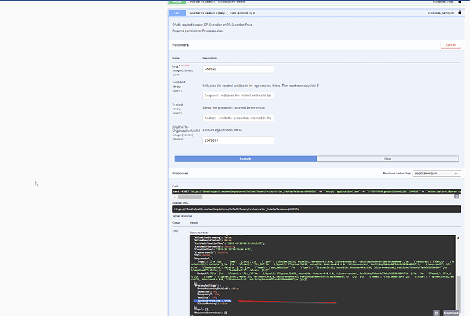

Example:
GET for https://cloud.uipath.com/ORG_NAME/TENANT_NAME/orchestrator_/odata/Releases(YOUR_ACTIVE_PROCESS_RELEASE_ID)
