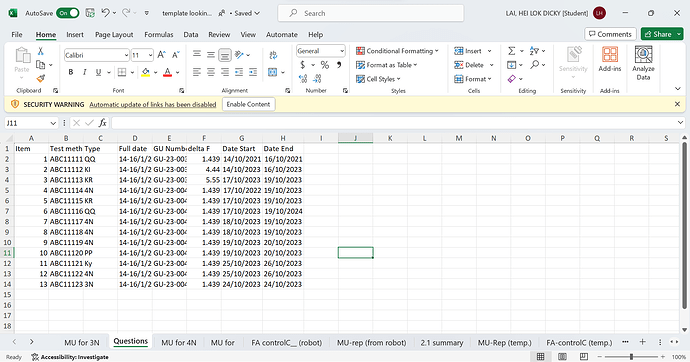

May I ask how I can re-arrange the row based on ‘Type’?
Now the output is:
But I want my output that is sort by “type”

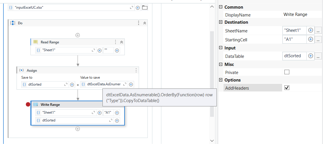

Read Range into a datatable
Sort Data Table activity
Write Range back to spreadsheet

Hey @Happydayyy
you can use this solution. Please take a look:
dtSorted = dtExcelData.AsEnumerable().OrderBy(Function(row) row("Type")).CopyToDataTable()
BlankProcess105.zip (11.4 KB)

You can directly use sort excel activity
It says “Data Table” so that is where you put your datatable. Also, you have to fill in the rest of the properties in the Properties panel.
