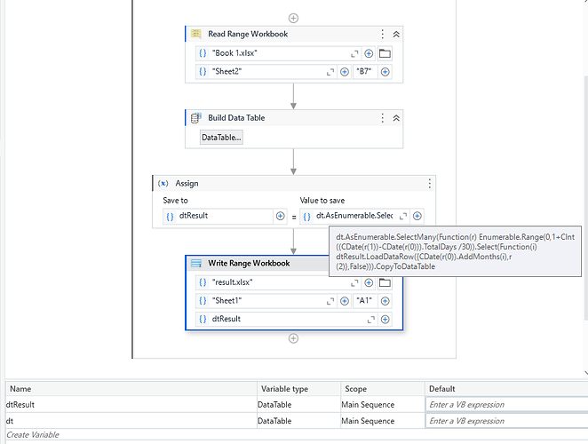

output should be only month and year like dec-23 like this but it is like
can you make the change
How about the following?
Sample20240130-3 (2).zip (18.4 KB)
or please set “mmm-yy” as CellFormat in advance.
End month is getting repeated
how to solve this
The above sample assumes input date is 1st day of each month.
Can you try the following sample? it works input is any day.
Sample20240130-3v3.zip (14.6 KB)
can you explain the logic
dt.AsEnumerable.SelectMany(Function(r) Enumerable.Range(0,1+(CDate(r(1)).Year-CDate(r(0)).Year)*12 +(CDate(r(1)).Month-CDate(r(0)).Month)).Select(Function(i) dtResult.LoadDataRow({CDate(r(0)).AddMonths(i).ToString("MMM-yy"),r(2)},False))).CopyToDataTable

It is not handling null values how to modify it
Capture230
getting this error

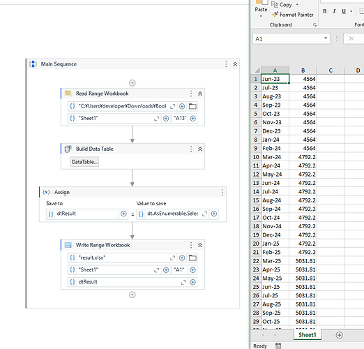

If you read unnecessary rows in the ReadRange, can you try to add the following FilterDataTable activity?
Book 1.xlsx (12.8 KB)
sheet1 input
sheet2 output
In my environment, it works without error as the following.
Did you set proper address of cell?
yes I have set the proper address of cell
in input b column is empty
Capture231
iam not getting jun-23 to feb24
I want headers also
