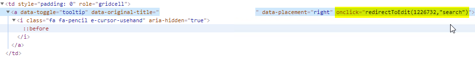

Thank you for your answer, but I have a problem . this function is on the page. but why not found error. image
did you select the correct page in the inject js activity?
Yes I did.
The error states the signature of your function is (String, String).
But you are passing a number, string.
Could that be the problem?
