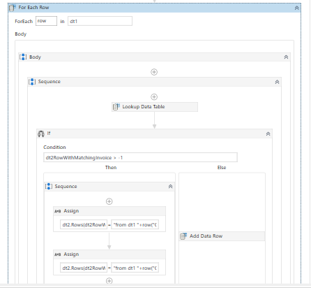

Example
  1. read dt1 and dt2
  2. foreach dt1
    a) lookup dt2 using dt1 invoice number
  • if match exists, just replace some columns in dt2 e.g. replace Column2 and Column3 in the corresponding row in dt2
  • if no match, just add the row from dt1
  1. write the new dt2 table
This is the updated dt2
Heres my sequence/excel
dt2.xlsx (8.3 KB) dt1.xlsx (8.3 KB)
Sequence.xaml (10.5 KB)
