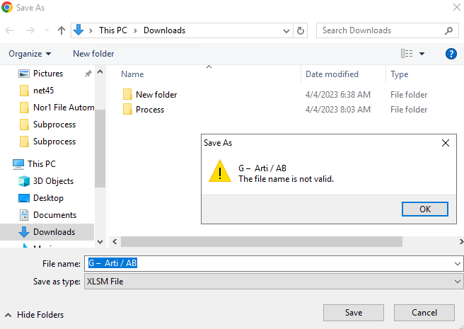

This is my file but when i download it gives an error file name is not valid and without '/ ’ all file are download then how i remove '/ ’ from file name while downloading

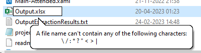

Hi @yogitagaikwad2206 ,
We will not be able to use certain characters in a file name :

Does the file name insert automatically in the file name field ? Have you already automated this step ?
You would basically require to use Get Text activity to get the text in the field and then type the value again by performing a replace.
YourGetTextValue.Replace("\","")
A better method would be to use a custom file name that you could define and perform the Type Into in the field.
