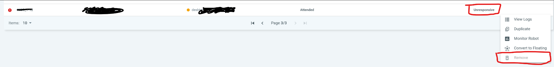

I want to delete a connected Robot, but the delete button is not activated.
The machine is currently broken, so I cannot disconnect it.
I’d like to at least disable the Attended licenses that are assigned to it, but I can’t.

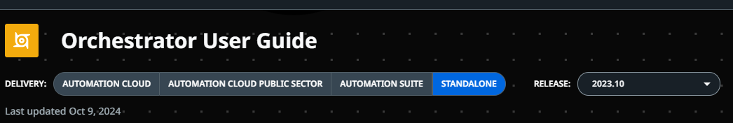

You can also check out this documentation
Orchestrator - Managing Machines (uipath.com)

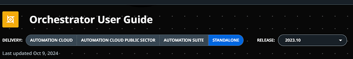

Select your version from here and see if you find something:

I solved it by directly modifying the status value in the DB.
