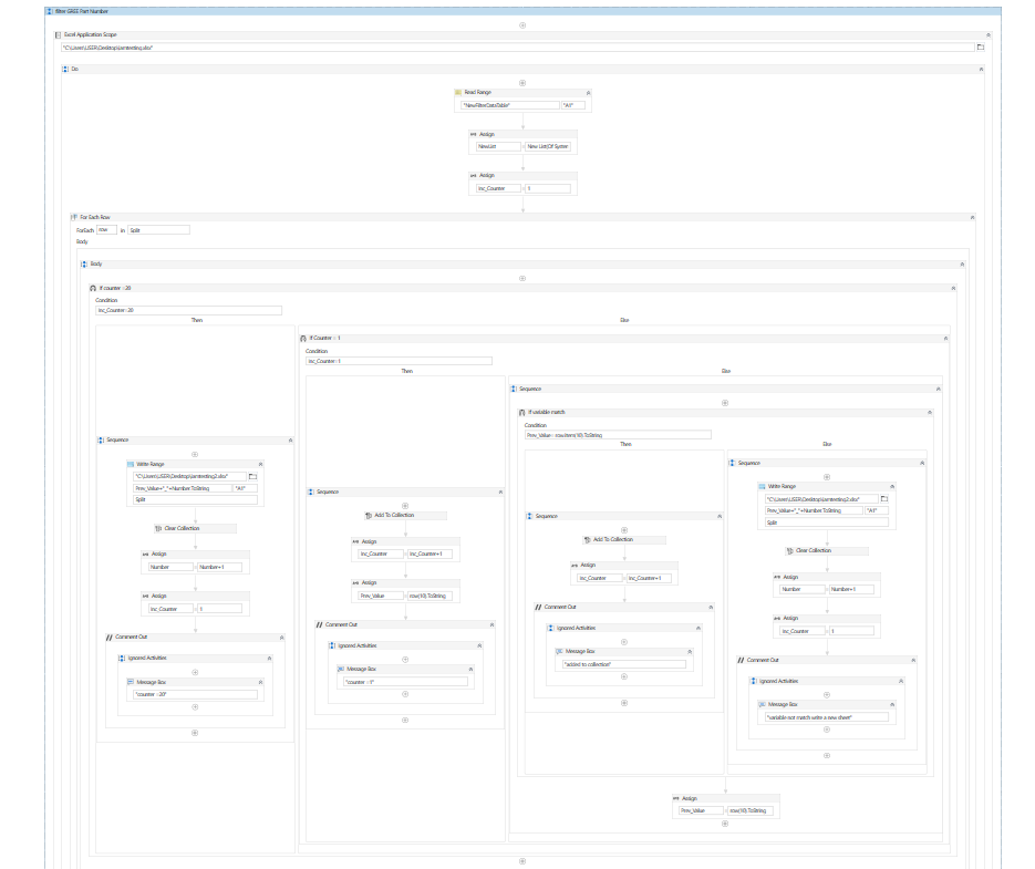

I am having trouble with more then 800+ records in excel, how to base on a condition to get 20 rows in new sheets.
E.g workflow, open excel sheet read through excel, get a variable from a col lets say “1” in first row, if next row same col contain 1 i add into collection or save into data row, then if i save up to 20 records i create a new sheet with the variable name, if the records matching is not right, create new sheets with added collections, replace row.item to new variable keep looping.
My current workflow is open application> assign new list = New List(Of System.Data.DataRow)> for each records if col = “1” add to collection and assign the row.item = “1”, when next row contains “1” add into collection, if records stored up to 20 create new sheets and keep looping, if next row is not “1” write new sheet and assign row.item = new variable to loop through the excel.
but i have a problem with current workflow about the collection, the collection will always print all the existing records to another new sheets, can’t really get 20 records. can anyone help me out.

Hy @Aaron_Ko,
You could try someting like this:
Inside an ‘Excel Application Scope’ use the ‘read range’ activity
Use for ‘each row’ activity to loop through your data.
Add this rows to another data table
Use a counter, when it reaches to 20 use the break to exit the loop.
Is it clear to you?

Hy @Aaron_Ko,
First of all I suggest you to re-organize your workflow. Inside the ‘For Each Row’ activity use a flowchart instead of an Sequence. Use flow decisions instead of multiple ifs one inside of another. It is difficult to read and understand what you want to do.
Can you share your entire project file so I can have a look at it?
Regards

Hi william thanks the following attachment is my current workflow example… i don’t know why the add collection only print all existing data…
example with 20.zip (44.2 KB)
thanks you

my current workflow have a do while, inside of the do while loop i have a for each loop with 3 if else, first condition ForEachLoopOutPut=1 then add to collection, second condition when it is 20 records write and break clear collection ,third condition next variable is not matching, write new sheet and break,then clear collection.
Outside of for each loop i have assign my datatable to DT.AsEnumerable().Skip(foreachloopoutput).CopyToDatatable() and keep looping.
But when it reach to the end of the row, the remaining collection are not able to write into new sheet, and i don’t know how should i write the do while condition to break it out of the loop… could you please help me out .

Thank you william for you example you get 20 rows and write to new sheets, but what if records have 21, how to apply remaining records and write new sheets? thanks
Aaron
Hy @Aaron_Ko, you must use the good old same logic, using the counter to extract data, something like this:
You can wrap this workflow, to return a DataTable as Out Orgument, and as input, the first and last position you want to extract.
Is it clear for you?

yes i have something really similar with yours but i am using add to collection instead of add data row activity to collect my datarow from excel, i assigned DT=DT.AsEnumerable().Skip(foreachloopoutput).CopyToDatatable() when my counter is = 20 or when row.item is not match, but this method seems like not able to write the remaining records (e.g 801 records, current workflow can print 801/2 , but remaining 1 record not able to print, and the robot always occurs error because the for each loop can’t stop even it reaches the end of the excel row.)
