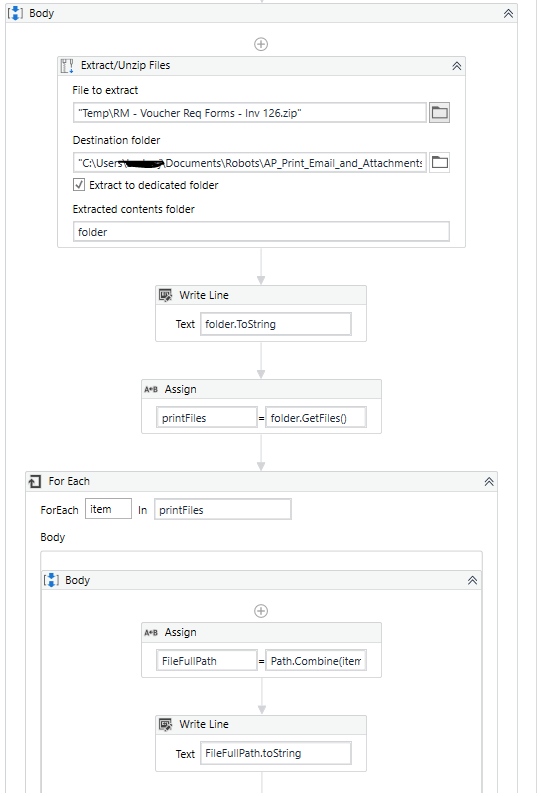

Hi @kerri.tiam2
After step 2, Using UiPath’s ‘Extract/Unzip Files’ activity, you should take advantage of the output DirectoryInfo
by adding an assign activity at step 2a
and for each loop at step 2b. Inside the Assign of For Each the variable FileFullPath is your extracted PDF file.

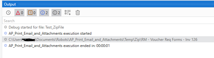

Hi @GreenTea ! Thanks for your advice :slight_smile: I gave it a go but it seems like my output of ‘Extracted contents folder’ is still picking up the main folder instead of the subfolder? I’m wondering if you have any idea what could be causing this issue? I have included screenshots below of my code and the output of ‘Extracted contents folder’ which is showing:
C:\Users\xxxx\Documents\Robots\AP_Print_Email_and_Attachments\Temp\Zip\RM - Voucher Req Forms
The folder where the files are stored in is actually:
C:\Users\xxxx\Documents\Robots\AP_Print_Email_and_Attachments\Temp\Zip\RM - Voucher Req Forms - Inv 126\RM - Voucher Req Forms - Inv 126
Hi @kerri.tiam2
Just Give it a Try
1)
2)
Regards
Sudharsan
Thanks @Sudharsan_Ka ! That worked :slight_smile: Not sure why I didn’t check StudioX activities in the first place! Much appreciated!
