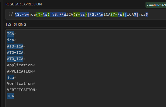

highlighted Words is Output.
@Gokul001 it Working But not Properly…have a Look Attahced SS…
Small ica is not Covered and I did not want APPLICATION,VERIFICATION.
Just want Following Words
ICA
ica
ATO ICA
ATO-ICA
ATO_ICA

Hi @kishan.savaliya
How about this expression?
System.Text.RegularExpressions.Regex.Match(YourString,"\S.*\wica(?=\s)|\S.*\WICA(?=\s)|\S.*\wICA(?=\s)|ICA$|ica$").Tostring
