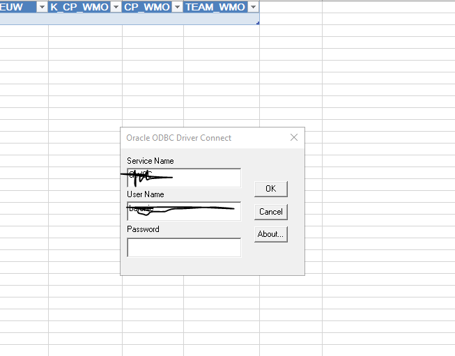

yes but still have problem with the password.
I tried also with type into function , but did’t work
Hi @Nightowl_music
Try with connect activity from the Database activities.
Odbc 32 /64 bit installed on your machine.
Regards
thanks, but no idea how to build this

There is a code to write password and username with VBA. You can write the code in your macro. I don’t have the link but you can search for it. It could help you.
