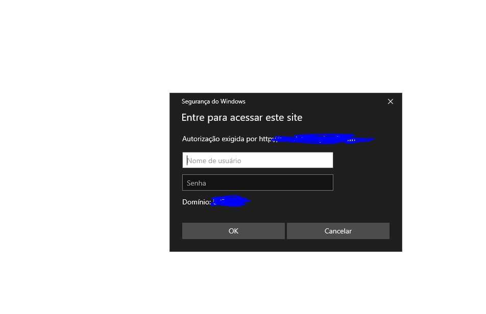

How can i login using http credentials into chrome/edge?
When I try to do the automation, I can open the browser, but when I try to fill in the login, UiPath understands that it’s a Harware Event

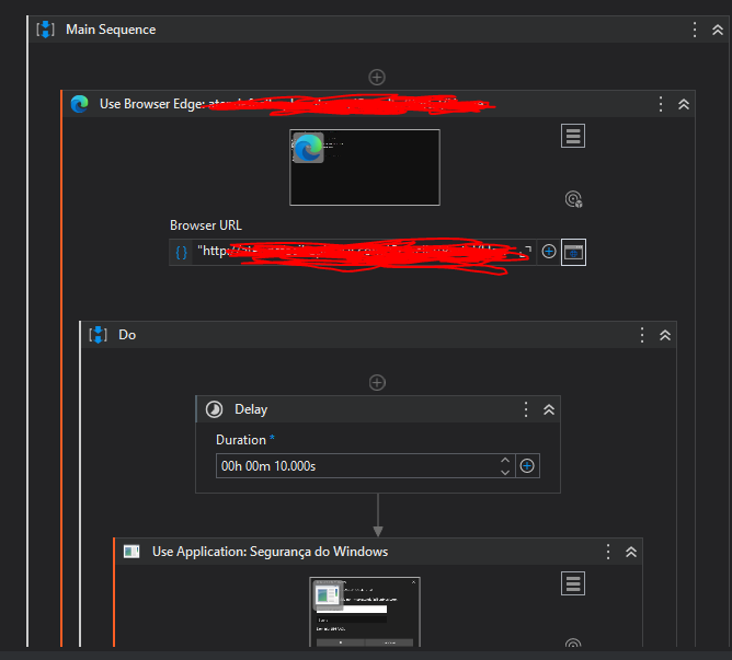

look this
UiPath create 2 “Use Application/Browser” activitie for it, but i got this error
If I change the input mode of the first activity to hardware event the error disappears, however, it is a browser and UiPath does not open Chrome

In use applucation/browser activity you can select what browser it is …please select it properly
Also you have options open and close where you can select never ,always or ifnotopen…select as needed
You need not open the second one…second window is a security ir windows window and not related to chrome…so do not open so it will attach to already open screen and remove url and check selector properly for the second window

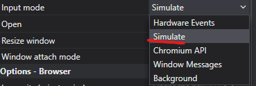

Hi @andre.nascimento
First of all you need a new use application/browser activity, attach the login window, make sure to use the Simulare as the Input Method propety
Make sure to set the Close and Open properties As “Never”

i got this error when i try type into login window
“The indicated element does not belong to the target application/browser.”
if you want to enter credentials in to window
Use another Use Application/Browser Activity and indicate the window
Use type into to enter credentials

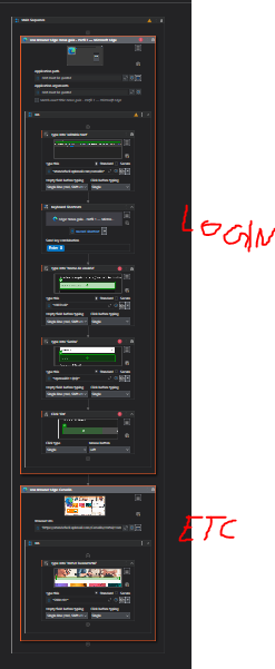

works for me now
structure:
Thanks !!
