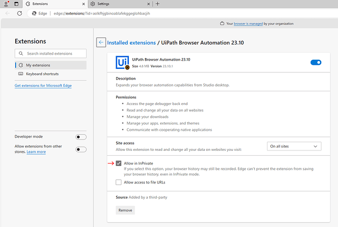

For now, can you try to turn on Allow in inPrivate in settings for the Extension of Edge browser?
Hi @rosshild21
In the properties of Use Application/Browser enable Incognito/private window to True. Enable Allow in Private in Edge browser of UiPath Browser Automation.
