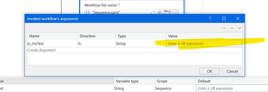

Can you ellaborate on this?
Hi @nmjvk
Click on the invoke arguments and then you will be able to see the in_myText in the popup and then in the right side you will be able to see the blank cell and then enter the myText variable in that row and that’s it close the popup and save the workflow. In this way you can assign the variables and the arguments.
After assigning that please click on OK and save the workflow and then you will be able to get the data in process xaml.
Regards

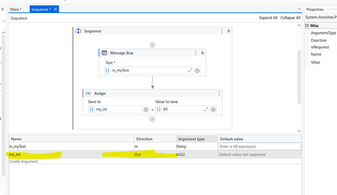

Perfect. Can you now show how to output the argument myInt which is an integer of the value 69 back to Main?
Here is what I am trying to do in Main, but it does not work. I get “0” back when it should be “69”
Main
process1

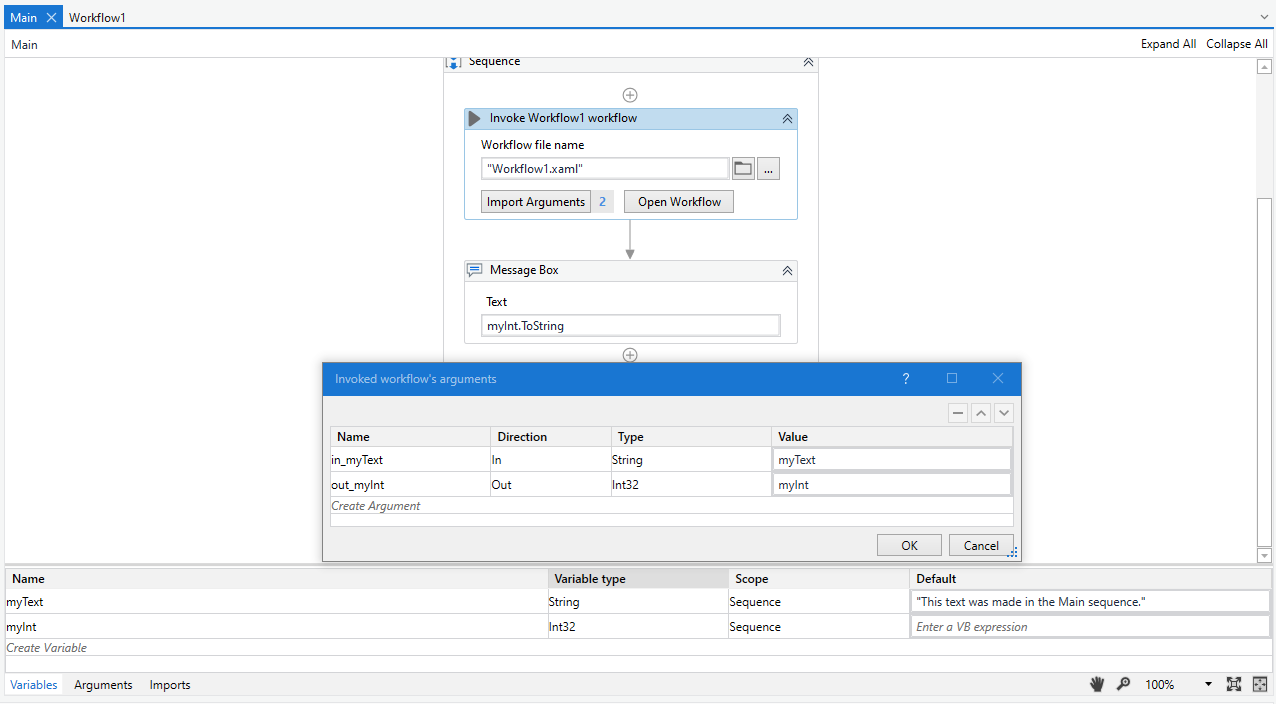

Hi @nmjvk
You need to create and argument in the process xaml and keep the argument type as out and save the workflow and now access the main xaml and click on the invoke and assign the myint argument to myint variable in the main xaml and then you can get the value from process xaml to main xaml. keep a message box in the main xaml as shown below and print the int value in the main xaml.
Click on okay and run the workflow.
