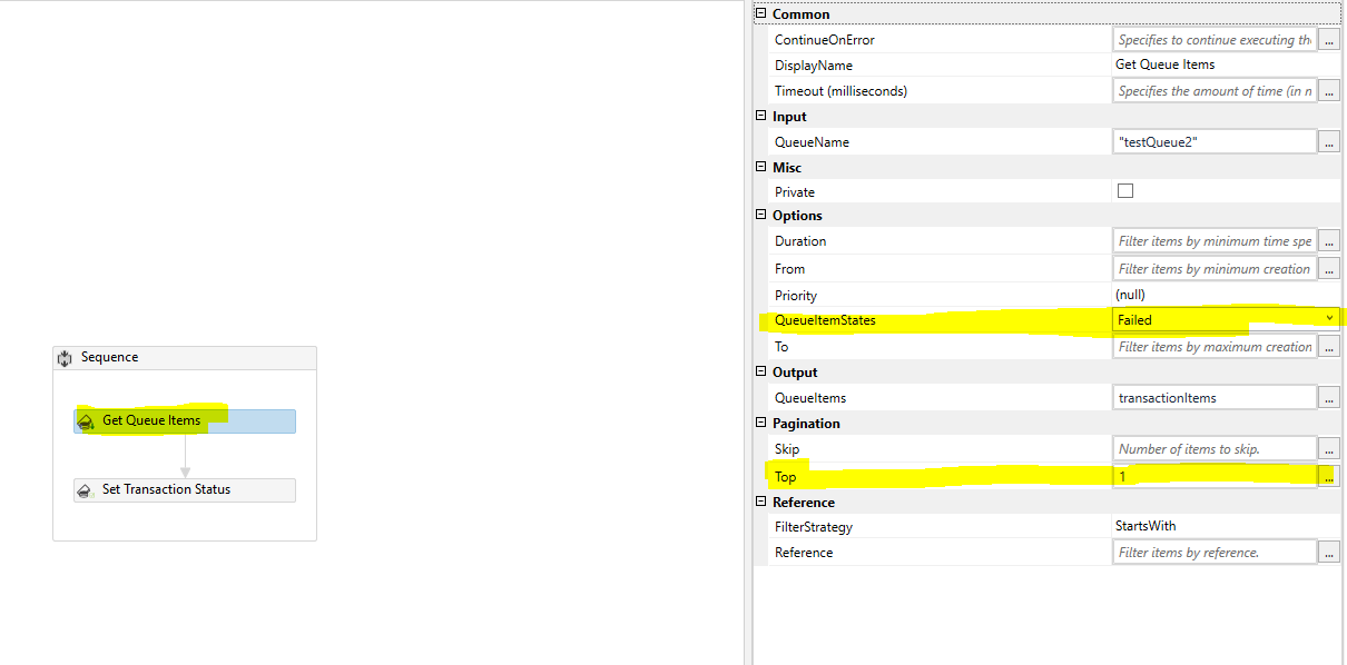

One way I can think of would be to try it like this, with the Get Queue Items activity:
I set it to return only failed items and only 1 of them (= effectively it’s a Get Transaction Item for failed items this way).

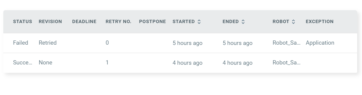

When we execute a process, we always retry all the items that end in Failed Application. Today this is an operation that we perform manually. For this we access Orchestrator and apply a series of filters on the view of the queues and View Transactions that allow us to select these items (Failed Application) and reload them in the queue.

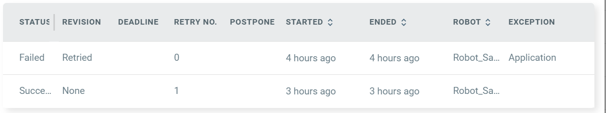

When we do this manually, the item generates a trace with the different states in which its execution has ended. It can be seen on the screen:
The status failed corresponds to the first execution, the succesful with the retry

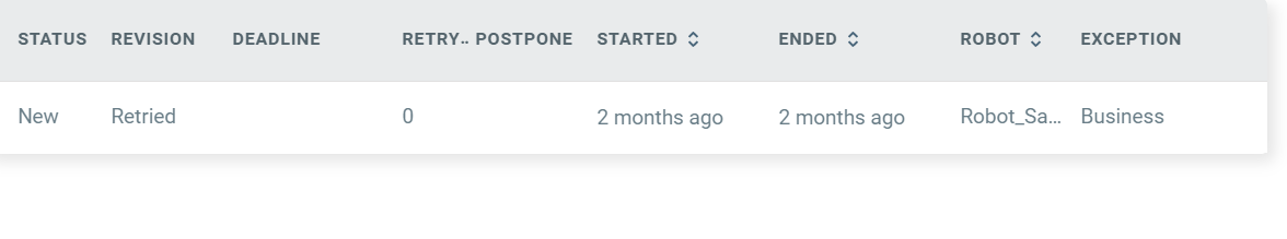

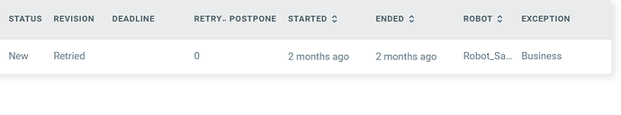

When we do it Updating the ReviewStatus column of the QueueItems table stays like this:
