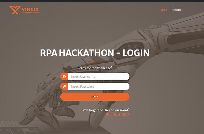

  2. After reading data from CSV file, I need to input values from each row into a website called “https://www.rpahackathon.co.uk/” (in the level 1 challenge). Thi s is similar to rpachallenge.com where we input values in the fields which change positions after every submission. Additionally in this website, random pop ups occur at random times. I need to click on cancel button in the pop up and continue work. I used global exception handler to identify and cancel pop up. But still my workflow doesn’t go to exception handler, it keeps inputting values even though there’s a pop up. Below is my project file:

I could not test or suggest where you can have a try-catch as I was greeted with a login screen.
