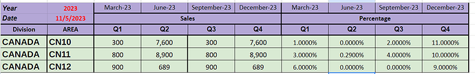

We are having a sheet in this format
How can we find for CN12 the Q2 Percentage from column H
Output expected: 0 for Q2 CN12
I have tried the following approach
1)To find the value using lookup
But during read range it gives duplicate name exception
Any other approaches are welcome:)

Read Range Workbook AddHeaders should be set false
@anmita
Yes, it will give duplicate name exception, but you can remove the add headers property to uncheck
So, that you can try with the Lookup and see
Thanks,
Srini

Hi @anmita ,
Could you let us know what was the Exception that it was producing when the Read Range activity Add Headers was unchecked ?
Hi @supermanPunch
Just checked yes by unchecking it working
Previously had added some other data table manipulation so it was giving those exceptions
Thanks again
