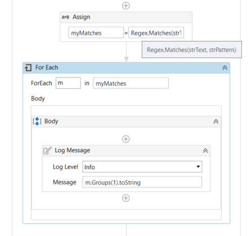

Check below for your reference
You can use Matches activity and give the above expression
Hope this may help you
Thanks
Could you please provide work flow.
Could you please workflow
@Red.Red
grafik
Log:
grafik
