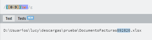

@Marcela_Lugo
Please try it out by using “Matches” Activity.
Then in the properties panel “Input” Textbox must contain your path as “D:\Usuarios\lucy\descargas\prueba\DocumentoFacturas092820.xlsx” or any variable where your “path” is present.
Then in “Pattern” Textbox give the value as “([0-9])\w+” inside double quotes, Then assign any variable to the “Result” Textbox and Put a write line below the Matches activity and give the expression as the VariableyougiveninResultSection(0).ToString

Thanks! But now I get the number in separate lines.
Now, this is my output:
0
9
2
8
2
0
How can I get the number in a single line?
I could resolve this using ToString.join, thanks to all for the help
