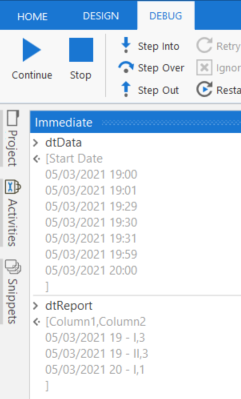

As a quick prototype approaching the case have we can do:
grafik
(From d In dtData.AsEnumerable
Let dp = CDate(d("Start Date").toString)
Let sg = {0,30}.toList.FindLastIndex(Function (x) dp.Minute >= x)
Group d By k1=dp.toString("MM/dd/yyyy HH"), k2=sg Into grp=Group
Let sl = {"I", "II"}(k2)
Let ra = New Object(){k1  & " - " & sl, grp.Count}
Select dtReport.Rows.Add(ra)).CopyToDataTable
Sample input/output
grafik
Afterwards we can adopt e.g. on
  • DateParsing
  • Customization on Group Label

Hi @ppr Thank you soo much!!! this worked like a charm! Now I’m able to get the values for 30 minutes interval as expected! thanks a lot sir!
