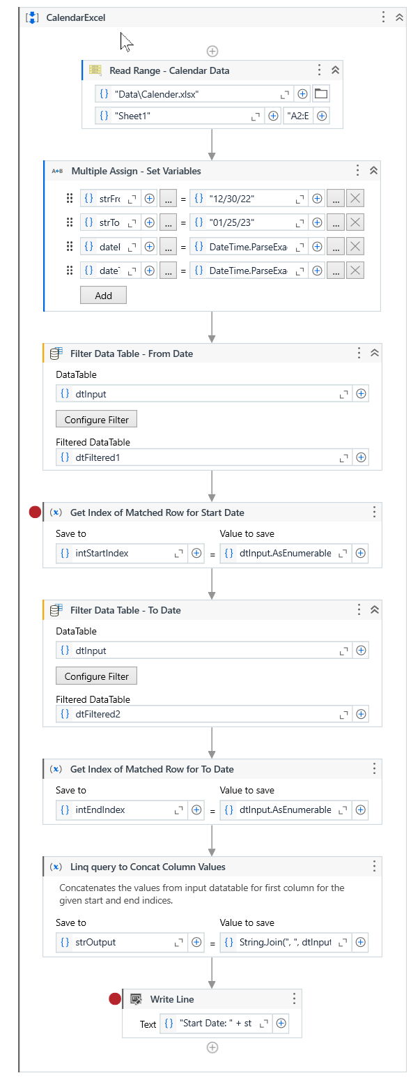

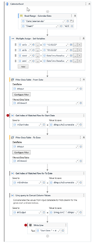

Here you go -
Result:
Xaml:
CalendarExcel.xaml (14.3 KB)
*Note - Update input file path as per your environment and also take care of exceptions. Considered only happy path. *
Workflow Screenshot:
Kartheek Byggari
