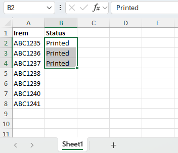

Hello,
Thanks for giving solution.
I have tried with this logic, but it gives me output as 1. ideally it should give 3, because 2nd is Last used row in B Column.
Tried below.
Input_DT.AsEnumerable().Where(Function(row) Not String.IsNullOrWhiteSpace(row(“Status”).ToString)).Count

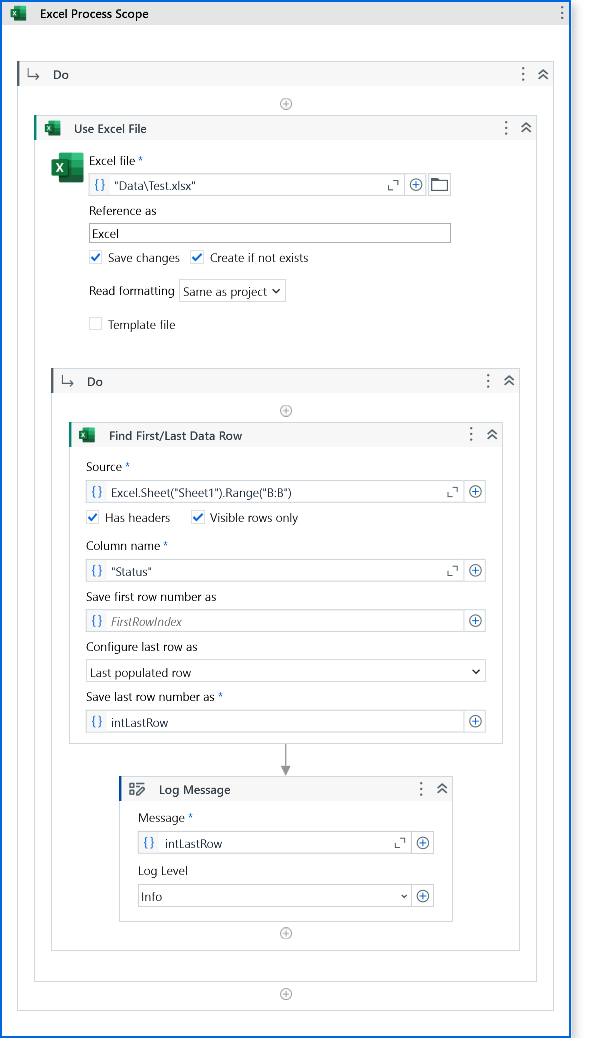

@nilesh.mahajan
You can also use inbuilt excel activity Find first/last row data row
and you can use it as num+1 to get next cell and use one
Hope this helps!

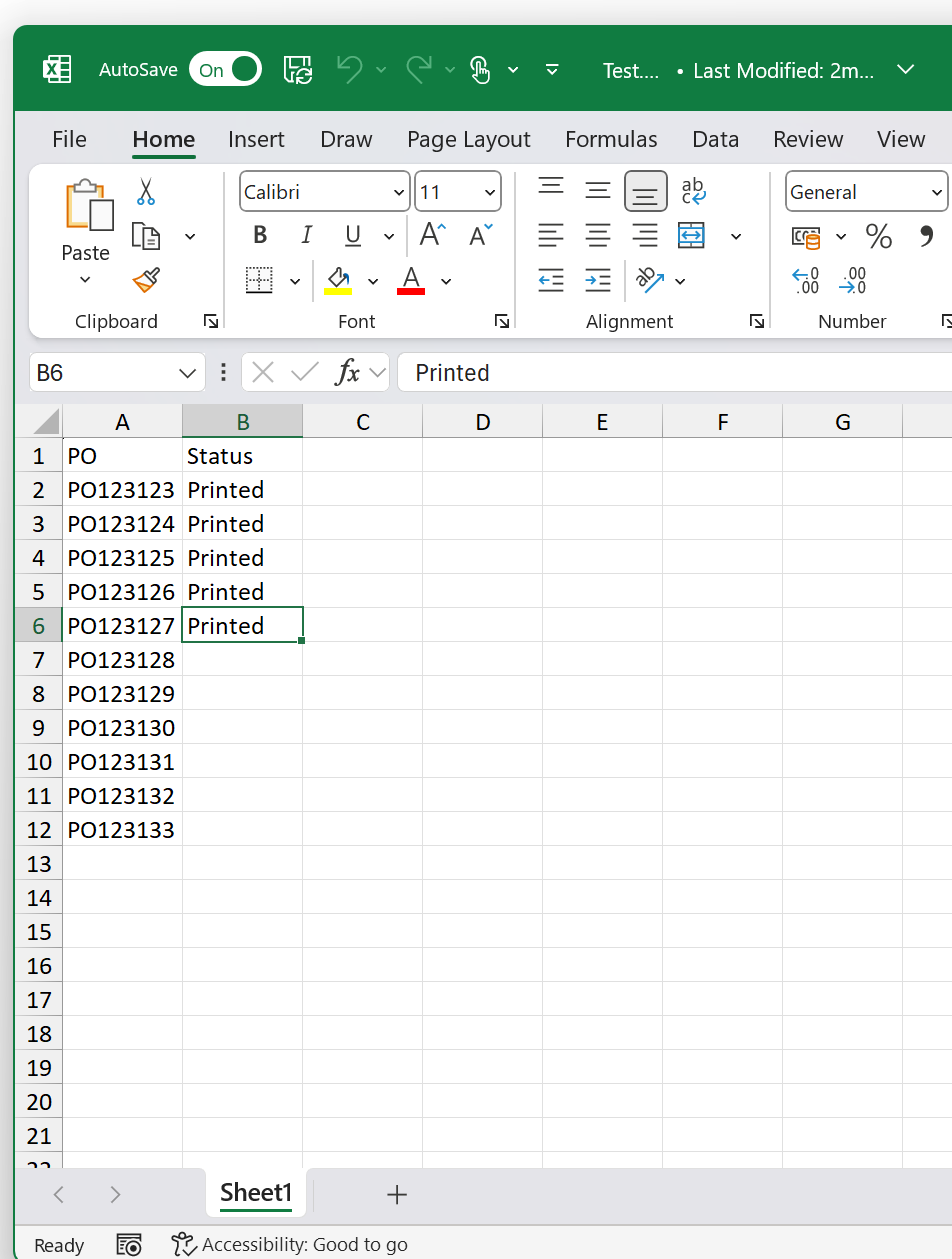

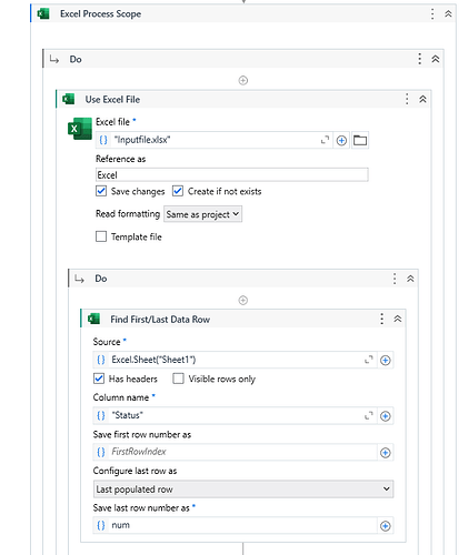

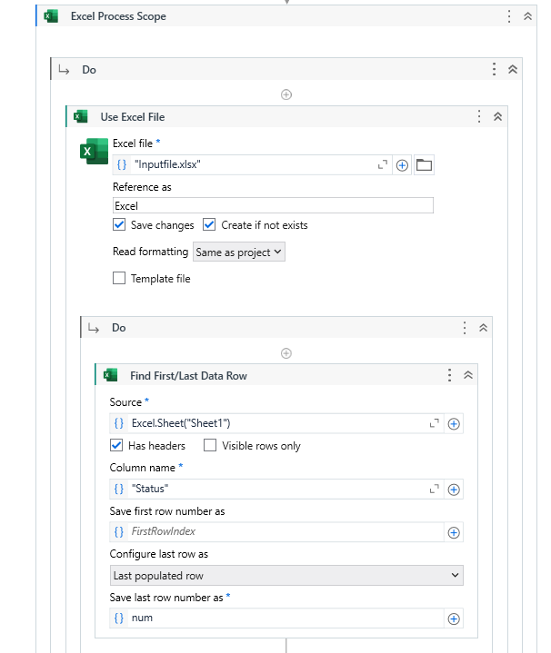

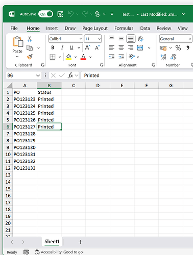

@nilesh.mahajan,
Follow this solution
Input file:
Code:

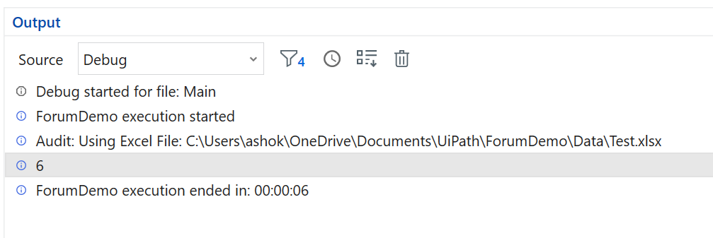

Output:

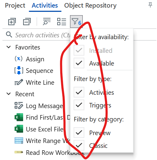

Thanks for Suggestion. But I am not able to find Excel Process scope in my activities. even in Manage Packages also not able to get.
Can you please guide me on this.
Thanks a lot @nilesh.mahajan! :heart_eyes:
Install the UiPath.Excel.Activities package and check the activities filter you selected all the options like this:
