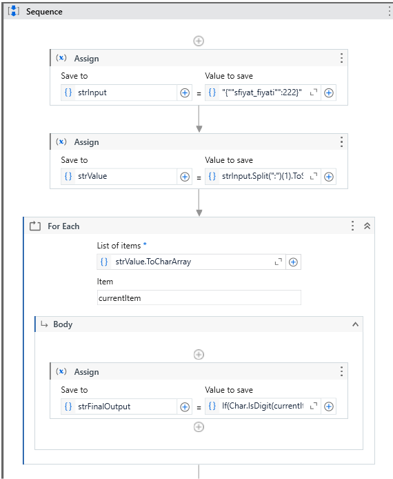

As it is JSON we can do directly like:
grafik
In that case here you go. It’s lengthy but you are open to optimize it.
