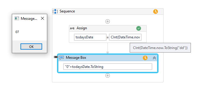

Hi @Damodara_Rao_Punugubati
Below is the solution for your query
Mark as solution and like it :slight_smile:
