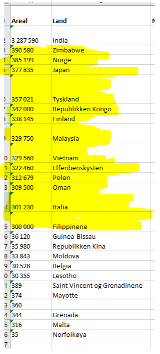

I have scraped this a website, where Im taking out the “Land” and “Area in km2”, and write it to a datatable.
Then I’m going to get the “Land” that have an “Area in km2” between 300 000 km2 and 400 000 km2. But I got more than I wanted (see picture).
I think is the numbers in Excel is String and not Integer or something.

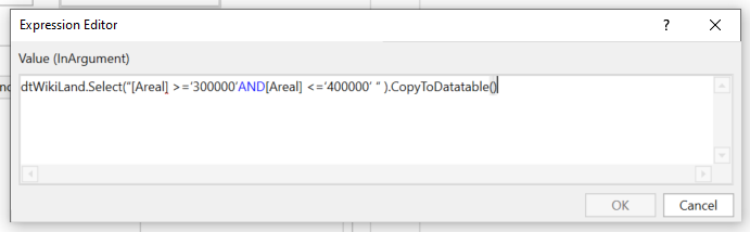

I got this error message, see picture.
Her is my test xaml: HentUt_Areal – Kopi.xaml (15.8 KB)

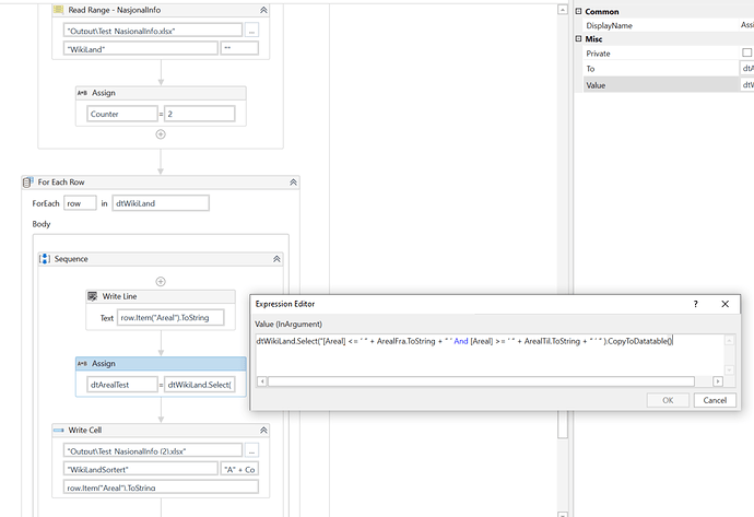

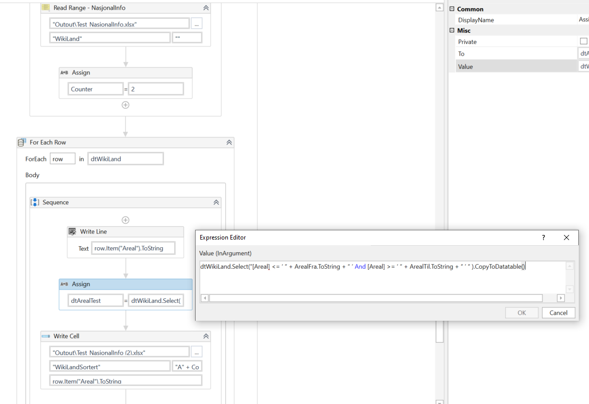

Hmm I get the same error message.
“ArealFra” is from input dialog with value 300000
“ArealTil” is from input dialog with value 400000
I will get the values between this range.

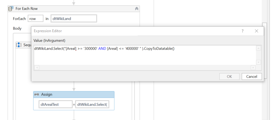

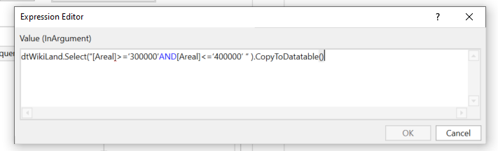

I tried it now, got this.
Her is my expression:
Have you kept any space between > and =
There should be no space
Kindly re type it please
Cheers @Mariafig
Thanks :slight_smile:

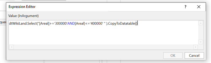

Im sorry, but now I got a new error message:laughing:
No worries buddy
There should be no space between > = it should be like >= and similarly for <= applies same. it should not be like < =
Where in the expression you could be able to see the red curved line next to [Areal] in the beginning of the expression. that implies the same
As there is space between the operators > and = and also in < and = we are getting the error
Mention without any space
Like
and kindly dont copy this and paste, that might errorout sometimes, type this expression with the field @Mariafig
