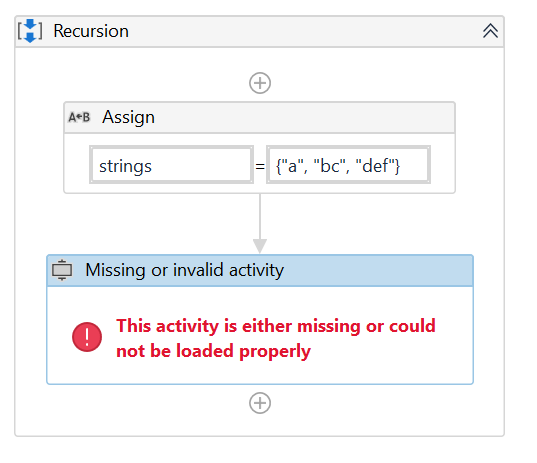

Thanks @T0Bi , Tell me Which Packages you include in this Workflow? Because I got many error when opening the same. Seems you’re using newer version of UiPath.

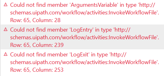

I have deleted the JSON file and start again but still got the following Errors :
Thanks in Advance
@hsendel which UiPath version are you using?
It seems like you’re missing the updated 21.4 activities.
This is just the invoke workflow activity, you can replace it with yours if you don’t want to upgrade.

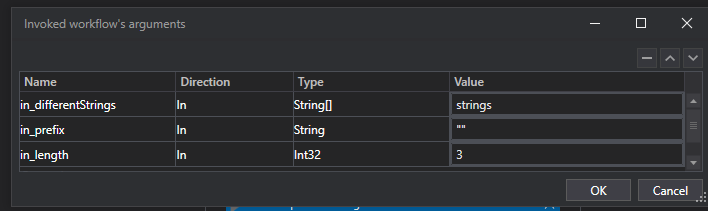

You can change the 3 to whatever value you like in the first invoke workflow activity.
Change the value of in_length here

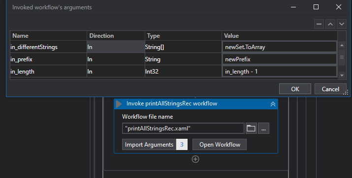

It’s a small workaround but the easiest way for now:
I basically added two activities to create a new List with the remaining strings and used that going forward.
New xaml
printAllStringsRec.xaml (9.0 KB)
