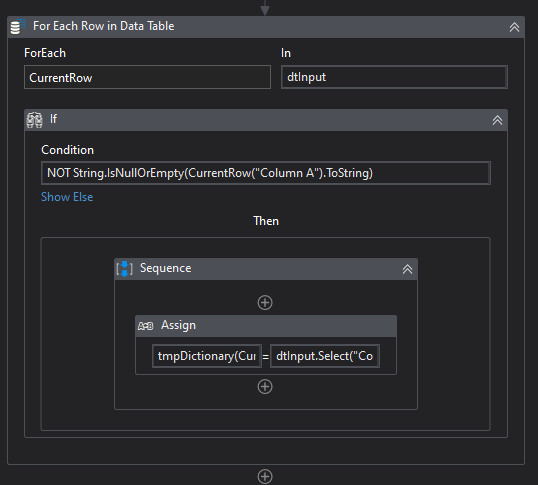

Not possible to install those packages in my Studio? If this is the case, Could you please share print screen of those "For Each " Activities I will implement them from my Side.Thanks
Mate you really should upgrade to 21.4
You’re missing out on lots of new features.
NOT String.IsNullOrEmpty(CurrentRow("Column A").ToString)
Assign:
tmpDictionary(CurrentRow("Column A").ToString) = dtInput.Select("Convert([Column B],System.String) LIKE '" + CurrentRow("Column A").ToString + "*'").Select((Function (x) x.Item("Column B").ToString)).toList
If this has helped you, please mark this answer as the solution.
