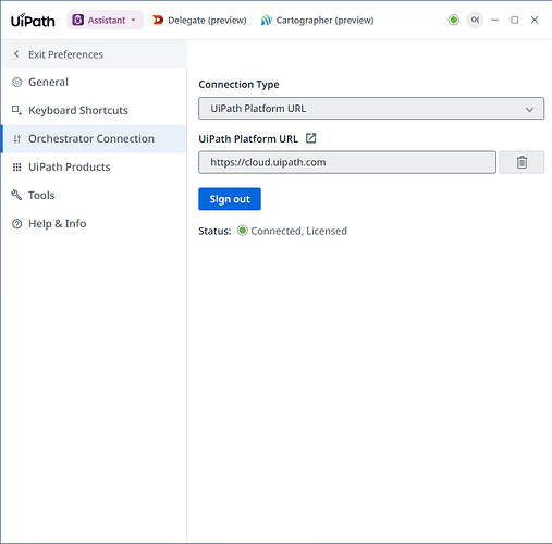

Hello @kauveryrpabot,
From what I see in your screenshot, you are using a UiPath Automation Cloud URL, so there are the following configuration possibilities depending on the license you use:
  • (Community License) → UiPath Platform URL → https://cloud.uipath.com
  • (Enterprise License) → UiPath Platform URL → https://cloud.uipath.com/{organizationName} ← Replace {organizationName} with your organization’s name.
(Screenshot UiPath Assistant 2026.0.200 - Community License)
(Screenshot UiPath Assistant 2024.10.20 - Enterprise License)

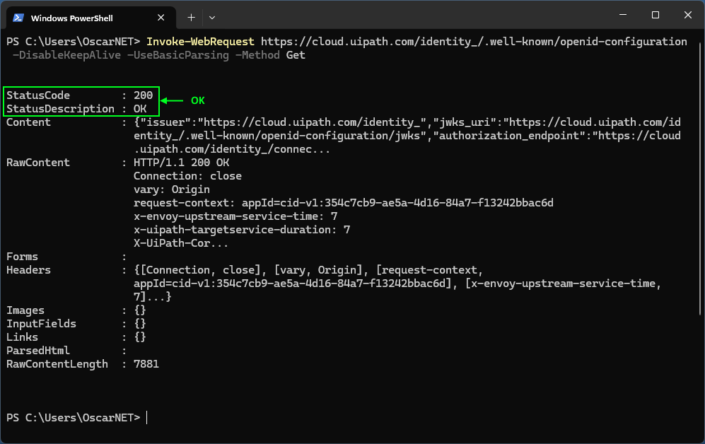

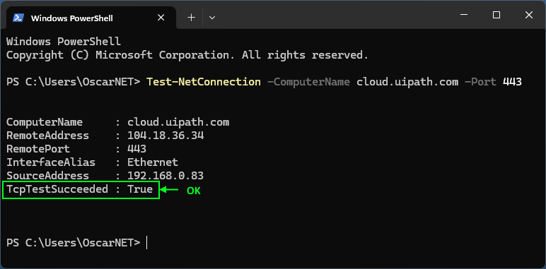

Once this is clarified, if you are still having issues with logging in, I recommend performing the following connectivity tests with the platform. To do this, run the following PowerShell commands from your computer (to open a PowerShell window, press the key combination WINDOWS + R and run the command powershell):
  • Check HTTPS connectivity to the UiPath Automation Cloud platform:
    Test-NetConnection -ComputerName cloud.uipath.com -Port 443
  • Check the status of the identity server of the UiPath Automation Cloud platform:
    Invoke-WebRequest https://cloud.uipath.com/identity_/.well-known/openid-configuration -DisableKeepAlive -UseBasicParsing -Method Get
I hope this helps.
Regards.
