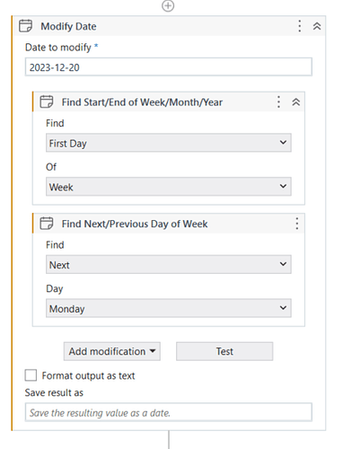

Working with Activities:
get first Monday from the corresponding Week - dateWeekFirst
Similar we can also get the corresponding Friday
As an alternate, we can work with an offset array
And can get the corresponding Friday
YourMondayDateTimeVar.AddDays(4)
