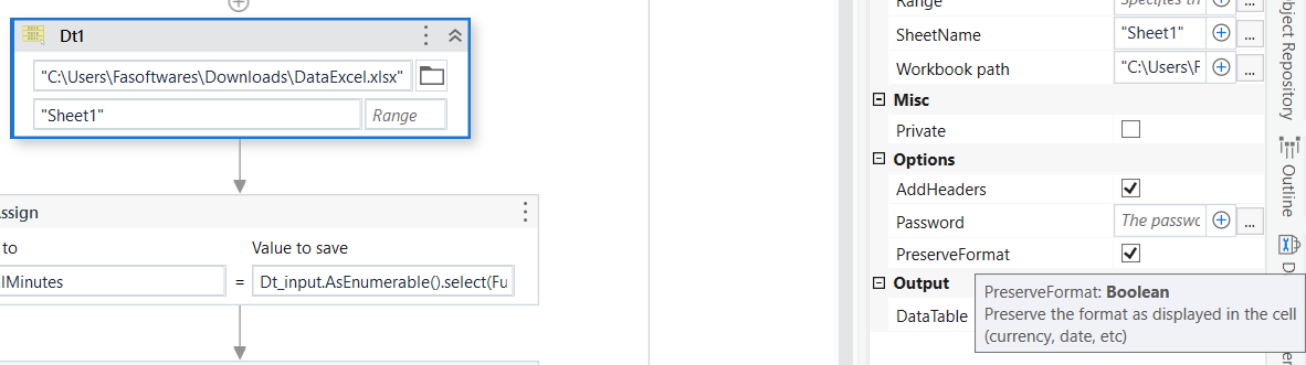

Hi @Chippy_Kolot
Try this
Step 1: Read range Activity → read the File (Note: Enable preserve format in the properties)
If you not Enable the property The value is not consider for timespan
Step:2: use Assign Activity
LeftSide: Total Amount(Variable type:Int32)
Value side:
1.To calculate Total Hours
Dt_input.AsEnumerable().select(Function(x) (x("Total time").ToString)).ToArray().AsEnumerable().Sum(Function (item) If(item.Contains(":"),TimeSpan.Parse(item).Hours,TimeSpan.FromHours(CDbl(item)).Hours))
**2. To calculate Total minutes **
Dt_input.AsEnumerable().select(Function(x) (x("Total time").ToString)).ToArray().AsEnumerable().Sum(Function (item) If(item.Contains(":"),TimeSpan.Parse(item).Minutes,TimeSpan.FromHours(CDbl(item)).Minutes))
Thank you
