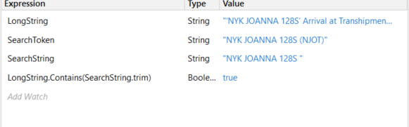

Have a look here
grafik
I hope you have done the compair on strings and not on splits or tokens with removed spaces

Looking to your feedback, could define a requirement like
From NYK JOANNA 128S (NJOT)
Use text without text in () = NYK JOANNA 128S = SearchString
And Look for LongString.Contains(SearchString)
grafik
I was using your split logic for extracting text without text in (). Removing the last space with the trim changed the result of contains from false to true
