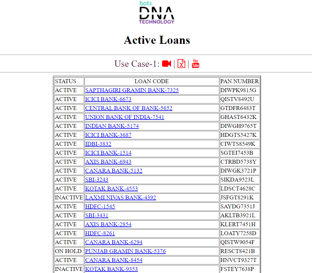

How to extract Status from website Table
How to extract Status And Pancard number from the table present in a website(http://botsdna.com/ActiveLoans/) based on last4digits on LoanCode
. Can anyone please help.
You can do something like this : (((From d in dt.Select Where d("LOAN CODE").ToString.EndsWith("7325") Select(d)).CopyToDataTable).Rows(0)(1)).ToString
Hi @Sriram_Gatla
Use Data Scraping to extract the data from the website since its Structured!
Regards
There are duplicated LOAN CODE : CANARA BANK-8454 and KERALA GRAMIN BANK-8454 in the table.
How do you want to handle the above?
