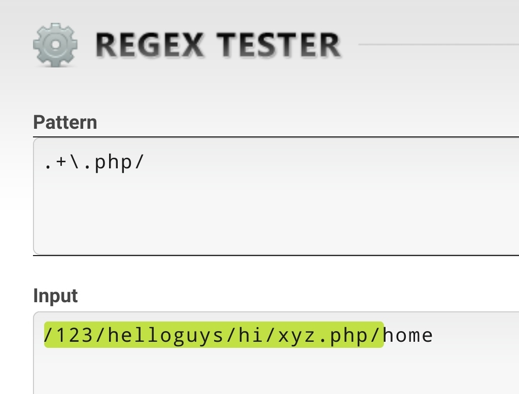

If there’s always “.php” in your URL, you can extract the part with this regular expression:
.+\.php/
newURL = System.Text.RegularExpressions.Regex.Match(oldUrl, ".+\.php/").ToString

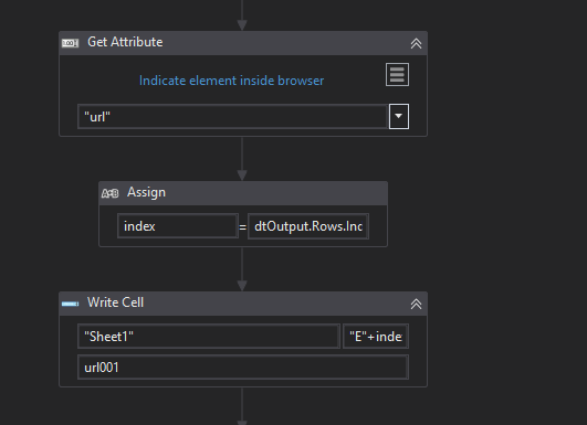

btw where to add this… i am new to this…
this is my work flow
Create a new Assign after Get Attribute.

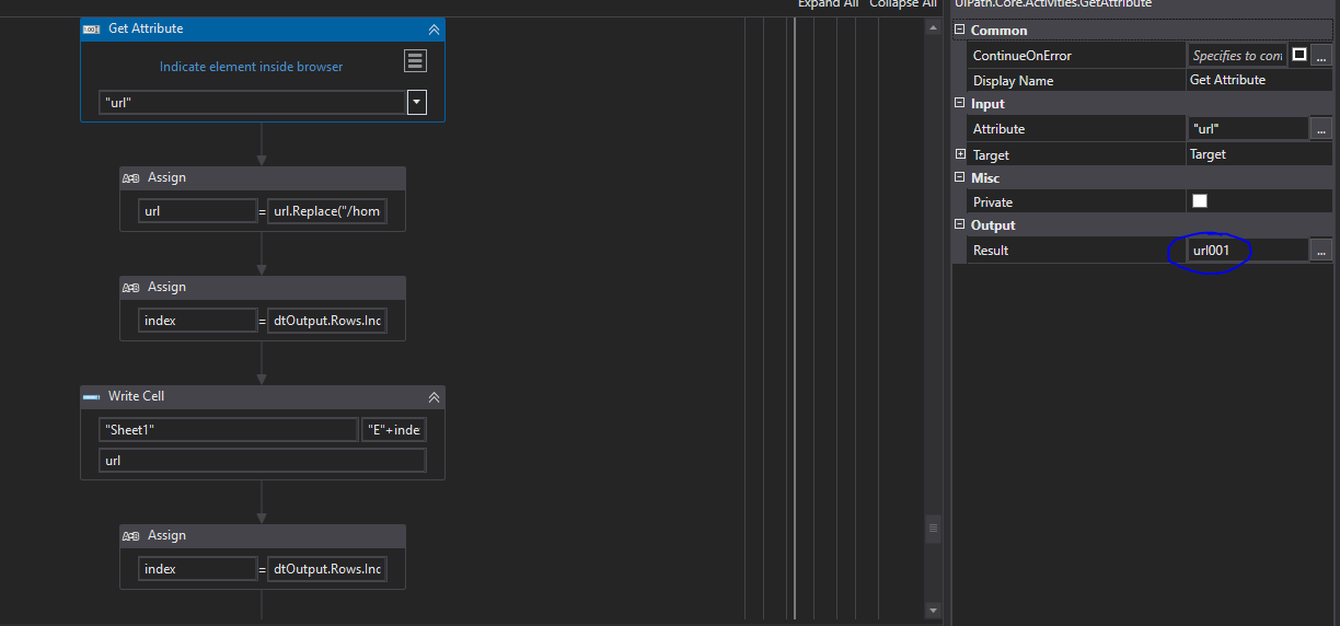

it showing me this error
You should modify the Result variable from the Get Attribute, which looks like url001. So you need to change the assign to:
url001 = url001.Replace("/home", "")
