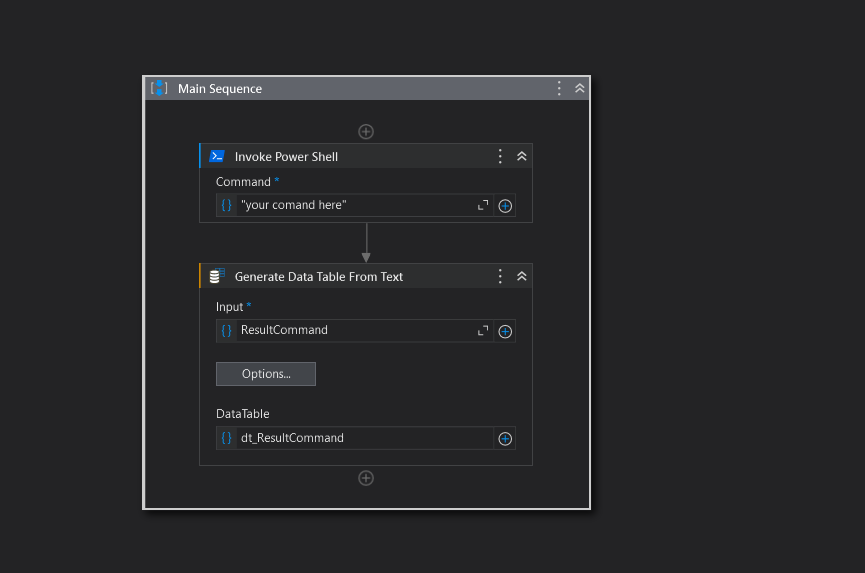

Hi @Anived_Mishra
how about use Invoke Power Shell activity instead run directly in CMD window?
Then you can use Generate Data Table From Text and configure it doing some tests. Maybe you will need to do some string manipulation before converting
Hi @rikulsilva thank you for your response. Yes, I’ve thought about getting it to data table and manipulating that, I was looking for a more elegant way to do this. Sorry forgot to mention this in the original post.
