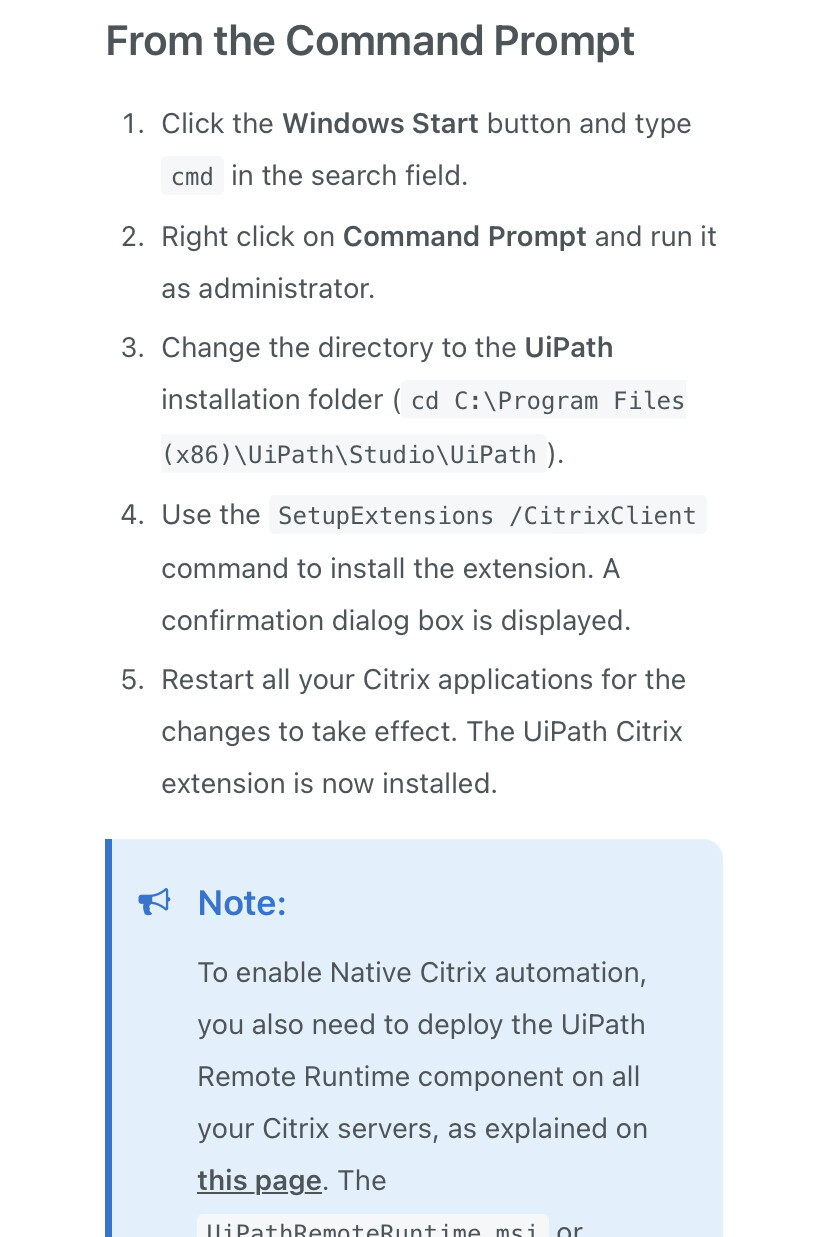

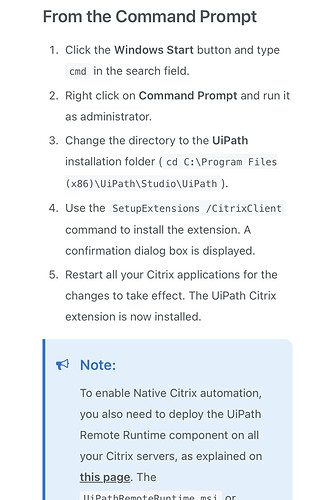

A citeix worskpace is to be installed first for this to be enabled…
If you are on citrix then you can see the option…
The same option can be availed from cmd as well
