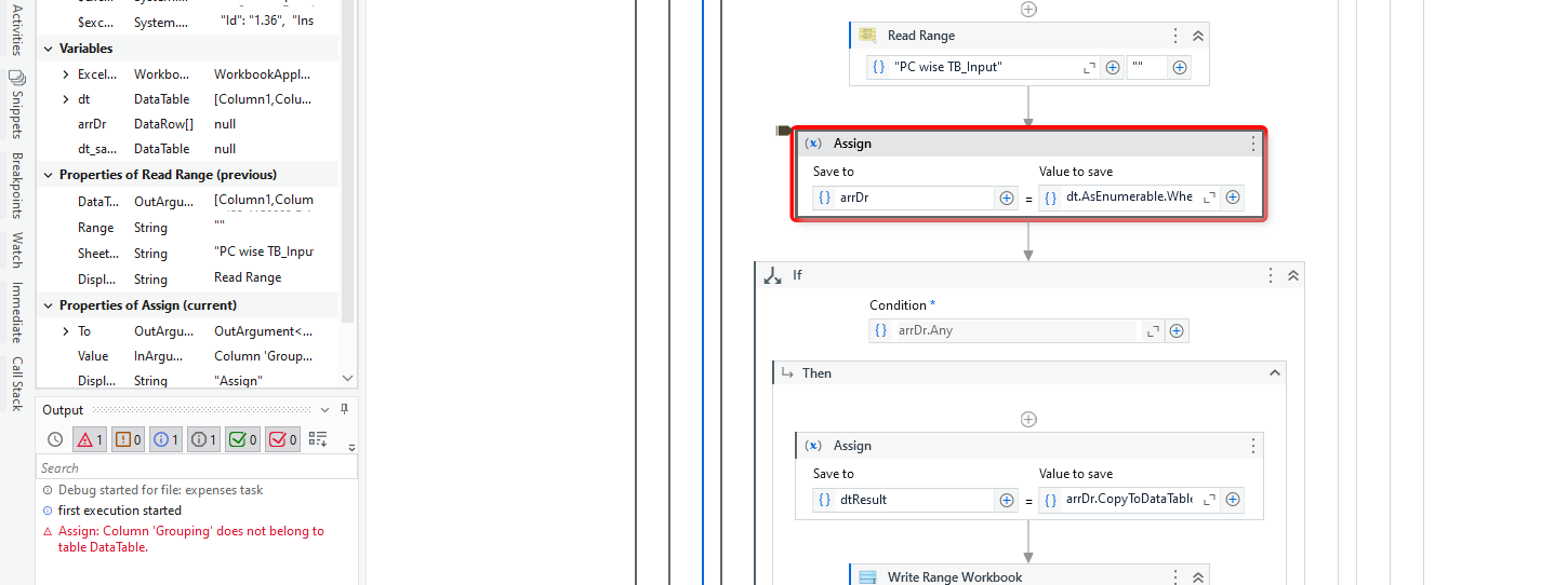

iam getting error that dept doesnt belong to datatable
Which sheet did you read? From Sheet2?
yes.from sheet2 to sheet1 but in sheet1 dept column should not display so i removed so that the error displayed
HI,
Did you try the above Sample20231026-3L (3).zip?
Does it works? (result.xlsx will be output)
It seems not same as my expression. (There is no “Gropuing” in my expression)
