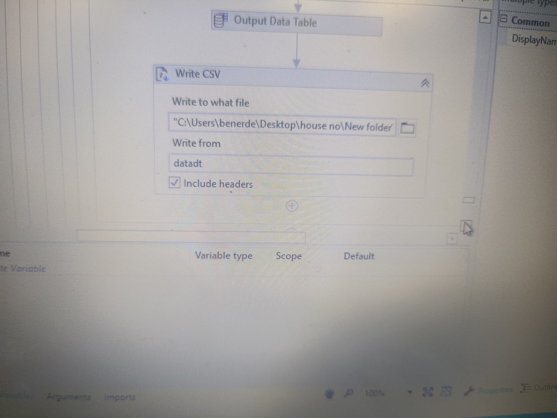

After each scraping activity I have passed the output to write line (to check)
And it’s showing up in output.csv
But this is only possible for 1 account as the number of scraping screen might increase or decrease for another
