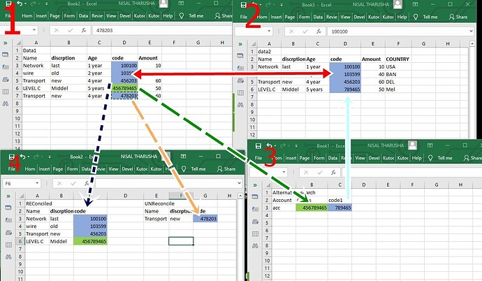

i have a small complicated vlookup
  • i have 4 datatables
    DT1 "code" coloum should compare with DT2 “code” coloum data
    if the code dt1 & dt2 “code” column data equal
    need to send to DT4 as Reconciled
    Challenge
    some times in Dt1 Code column has lager values**(green)** in that time i should compare the dt 3 with “code” 1 Column (green color) & dt2 that found code
if any of the records cannot found it should send to unreconciled sheet
Any Activity to archive this

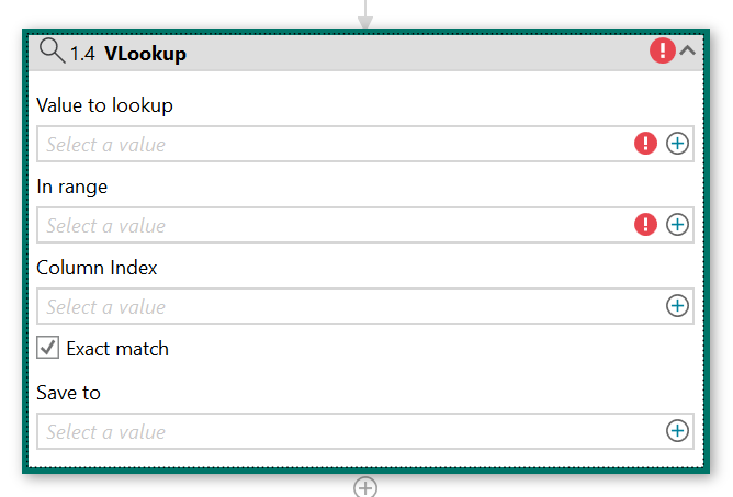

@Tharusha_Fernando - I would suggest to try this with StudioX using the VLookup Feature. Whatever steps you do manually (Vlookup in excel) , mimic that in Studiox to see if that works…
Hy @prasath17
i have done most development in studio so i m referring on that
Thanks
@Tharusha_Fernando - I understand that, but my point is if the above thing works in StudioX , you can open that xaml in studio it will still work(which I have already tried, see this post for reference ).
Also, for the datatable lookup, please check this video.
