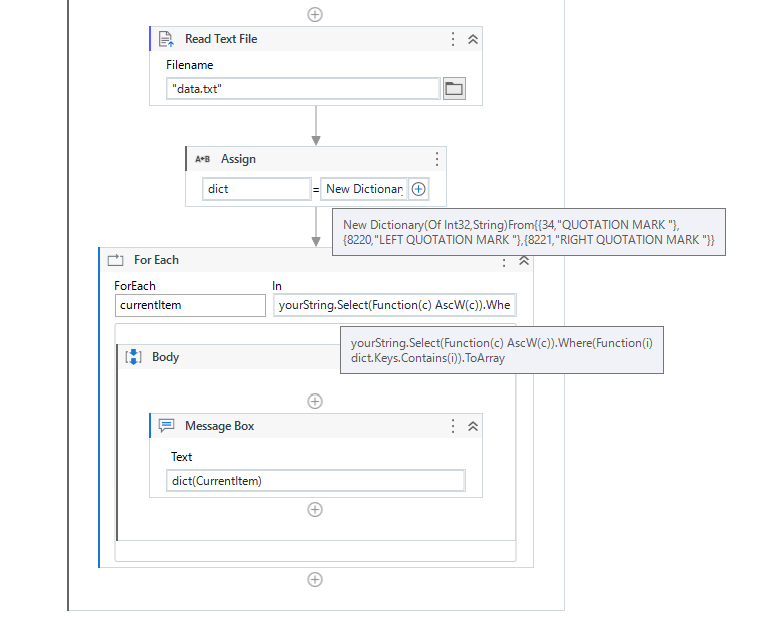

Hope the following sample helps you.
Sample20230313-AL.zip (2.8 KB)
