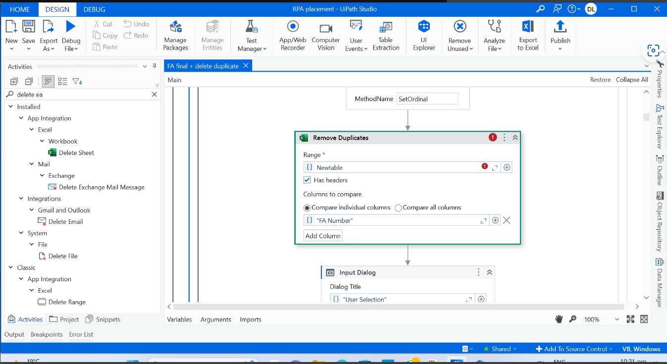

FA final + delete duplicate.xaml (65.2 KB)
Can you illustrate me how I can use this method? I am still confusing. Thank you so much!
if i use the delete duplicate activity, May I know that what is the range should be in my example?
Many thanks!
Workflow:

Okay @Happydayyy
Here you are not using Remove Duplicates activity with in the Use excel file.
Kindly, Drag and drop Use excel file activity inside of it use Remove Duplicates activity.
→ Insert Use excel file activity and give the path of the file.
→ Inside Use excel file insert the Remove Duplicates activity and give the range as below,
Excel.Sheet("FA for 4N")
Check the below workflow for better understanding,
Hope it helps!!
I have modified your workflow check the below workflow image and do modifications in your workflow as I did,
If you find the solution, Make my post mark as solution to close the loop… @Happydayyy
